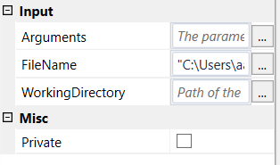

Did you provide full path of that .bat file or not ?
@MaheshShelke - Use Start Process activity and provide the complete file path. It will run the bat file without any issues.
Hi @MaheshShelke I tried to open .bat file with start process it is working.

Thank you for the reply, I tried with Start process, however it will flash on the screen and disappear again but not opening completely

@MaheshShelke
In such a scenario a crosscheck is recommended. Open the bat File manually and Check If IT IS working. In Case of the Same behaviour Happens Put a Pause in end of bat file. Maybe some helpfully Error Info can be retrieved.
Once IT IS working try IT again with UiPath ab start Process activity.
Also give a try to Put the path to the bat File within the Arguments sections and configured the filepath to the cmd.exe
Along with File Name, I have also mentioned the Working Directory with the folder path…and it worked
