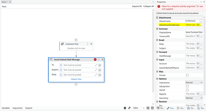

Hi @Mike_Brown1
You can send multiple attachments by using “Attachments Collection” you can pass the folder contains different files. Please find below ss for your reference.

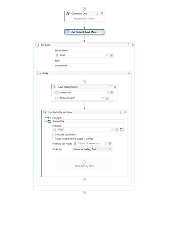

Okay, It looks like I wasn’t clear with my question! What I meant is this - Say Company Z gets the mail with 5 pdf attachments that need to be processed. Is it possible for the bot to read that mail and process all those attachments? Or can it only be one pdf per mail that can be processed?
Thank you!

Hi @Mike_Brown1
Yes it is possible to process all documents in mail by using for each to loop all documents.
Please find below image for your reference.
