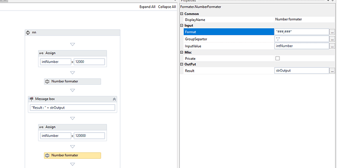

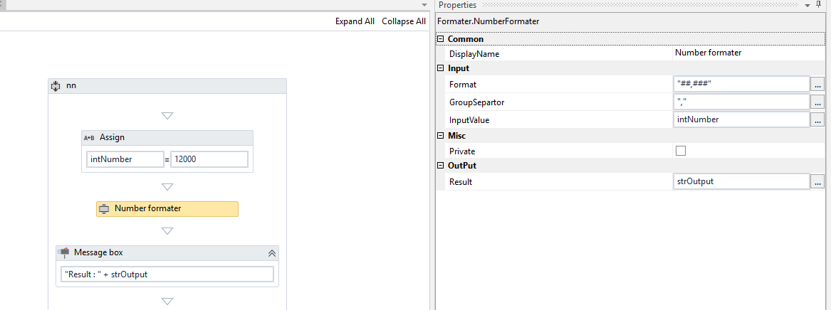

Hi @SagarSB,
Here is the example with output.
Output :
Here is the activity
File : nn.zip (1.6 KB)
Regards
Balamurugan.S

Hi @SagarSB,
Case-1
Format : “##,###”
GroupSeparator: “,”
Case-2
Format : “###,###”
GroupSeparator: “,”
Regards
Balamurugan.S
