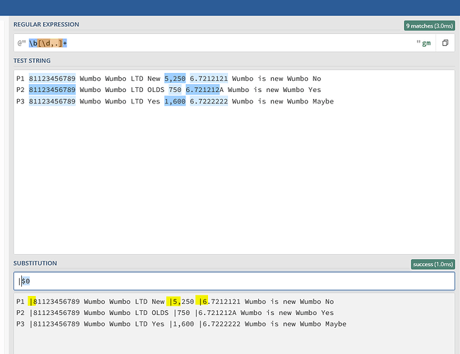

In general we have the approach of
  • set markers with different Regex, String method techniques
  • also can be done in a chain
Once all data is marked, then parse it e.g. generate DataTable or other approaches
Example Marker setting as 1 step in a chain:
next step:
so unclear / remaining is the Yes, no, maybe part

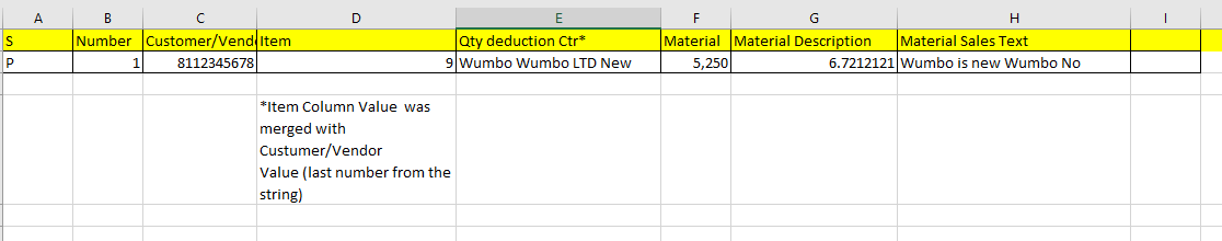

expected output
Would you be kind enough to help me on the steps by steps to generate this?
thankn you

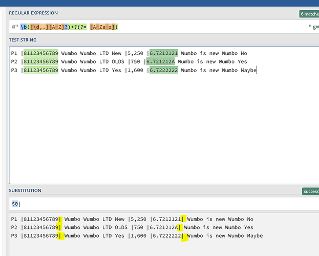

explore the above mentioned approach for more samples as
as we could drive the same strategy of marking, parsing, cleansing

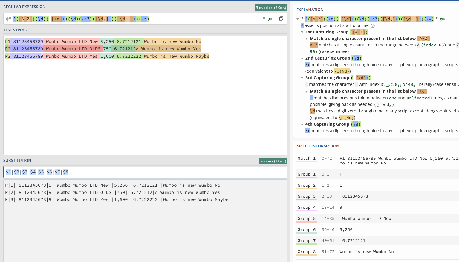

when new to regex cascading and marking can be more easy to get it done instead of writing a All-In-One regex
Have a look on this approach exploiting groups and substitution:
^([A-Z])(\d)( [\d]+)(\d)(.*?)([\d,]+)([\d. ]+)(.*)
