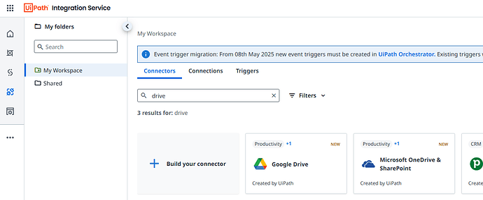

Unfortunately, the trigger doesn’t work even without a filter. update
without filter worked now. Maybe it took a moment for the filter to activate?!
Still nothing is happening with the filter update
I’ve now opened a ticket with UiPath Support.
I can’t figure out why it doesn’t work at all.
The settings aren’t actually that complex.
regards
By the way - I also tried the google drive trigger - unfortunately it doesn’t work either
