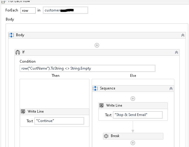

so this condition I can use in the inside the for each loop in beggning only right. so I want basically stop process process also after sending the email.? I don’t want my loop will itirate again.
Yeah, use it in the beginning and then use a break activity to break the loop @balkishan
That will stop looping and then it will execute next steps
Like this?? image

Instead of Breaking the condition directly you can use send email activity inside else condition and break the condition

Once you give break it will break the condition and it will come out of condition, it will not go to your catch block, because you have already given a condition to either process or break.
Exactly

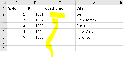

see this is the sample workflow, I am reading this and feeding the data into App. If I found the CustName is null then email and Stop the process.
