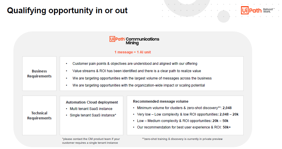

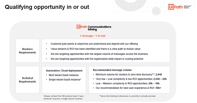

Hi @jouneid.guefif, maybe this helps. This is what’s on the UiPath slides.
