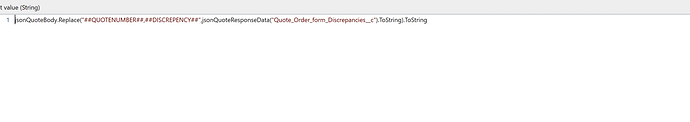

I have created json templace which i am replacing with dynamic values. Please let me know if the replace jsonQuoteBody.Replace(“##QUOTENUMBER##,##DISCREPENCY##”,jsonQuoteResponseData(“Quote_Order_form_Discrepancies__c”).ToString).ToString is correct?

Is the replace activity correct which I have used ?
@marina.dutta ,
Replace like this.
jsonQuoteBody.Replace("##QUOTENUMBER##",strQuoteNoVariable).Replace("##DISCRIPENCY##",strdescripencyVariable)
Thanks,
Ashok :slight_smile:

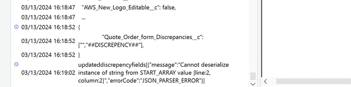

My output should be
however I am getting as below
@marina.dutta,
What’s the vAlues of the variables you are replacing the default values with?
