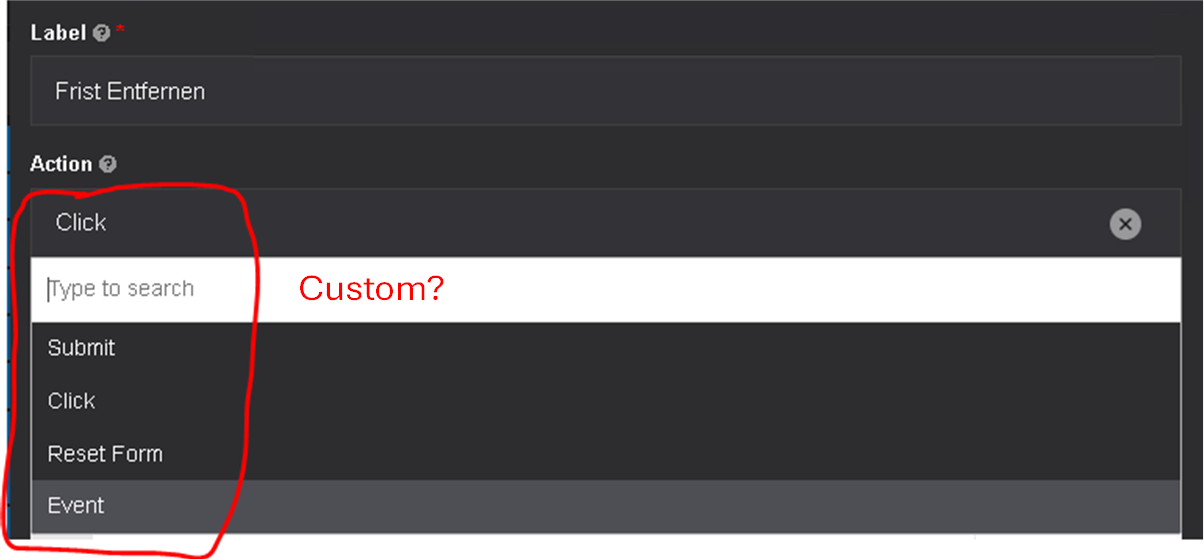

  2. Custom Code:
    In the Custom Code section, I added the following JavaScript to clear the Date/Time field when the button is clicked:
    form.getComponent('fristEntfernen').on('click', function() {
        form.getComponent('frist').setValue(null);
    However, when I click the button, nothing happens, and the Date/Time field remains unchanged.

@power
the only change is using ‘’ instead of null
form.getComponent('frist').setValue('');
Also in custom code just the above line is enough
Hope this helps
cheers

Thank you for the suggestion! You were absolutely right — the key to solving this issue was using '' instead of null to clear the Date/Time field.
The final solution was as simple as this:
I added this line in the Display/Update Data Logic section, and it worked perfectly.
Additionally, I realized that my issue may have been related to the Legacy interface in UiPath Forms, which could explain why I had a different view than yours.
