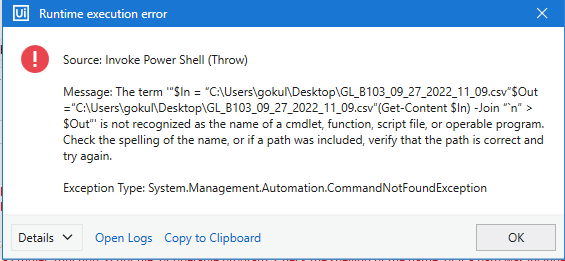

This is the powershell variable that i created to pass it to the powershell script
This is how i passed the variable to the powershell script
And it it throwing error like
Does anyone have the solution for this.
@Gokul_Murali you have powershell script and you want to add paths in it?
am i right?
Store powershell script like this in String Variable
->ScriptString=“$in = “{0}”
$out =“{1}”
(Get-Content $in) -join “`n” > $out”
then use
->String.Format(ScriptString, path1, path2)
use ScriptString in powershell activity
SINCE THE PATH IS CHANGING FOR EVERY RUN WE CAND HARDCODE THE PATH SO I WANT TO PASS THE PATH AS A VARIABLE
@Gokul_Murali Store Script like my suggestion. and put variable in it through String. Format.
Its a dynamic procedure.
do i need to put “path1” and “path2” instead of {0} and {1}
