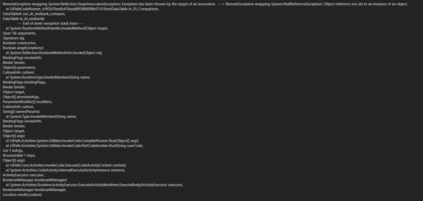

HI,
Can you share whole content of $excceptionDetails?
Ohh,Also Surround the code using Try catch for best practices!
Happy Automation! :slight_smile:
Exception
I guess out_dt_nedbank_compare is null. So can you try to add either of the following expression at the beginning of the code?
out_dt_nedbank_compare = in_dt_nedbank.Clone
OR
out_dt_nedbank_compare = in_Dt_Comparison.Clone
Thank you so much Yoichi it is now working
