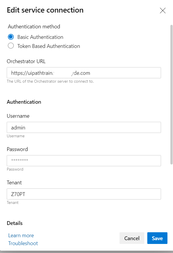

Hey Tomas,
My connection from Azzure to Orchestrator :
Thanks.
Regards.
seems you are using your own on-prem Orchestrator.
Pls make sure that you are not using a self-signed certificate for Orchestrator.
Hey Thomas,
The problem is fixed.
We were not invoking correctly the orchestrator folder, on our case needs to be “default”.
Thanks for all the support.
Regards.

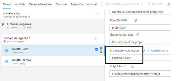

We are trying to configure a Pipeline for our UiPath proyects, to publish proyects in our orchestrator, but we have a problem.
After download and install UiPath plug in for Azure DevOps, the pipeline is pointing to “ConexionUiPath” that was configured as follow:
conexion Uipath
In “UiPath Pack” and “UiPath Deploy” tasks the configurations is as follow:
UiPath Pack:
uipath pack
UiPath Deploy:
uipath deploy

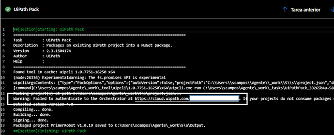

The problem is when we execute the pipeline. All tasks are executed OK, but we have a warning in the UiPath Pack task:
That warning prevents that the project has published in our orchestrator. We are sure that the credentials for the orchestrator are ok, because we are trying with 2 different “UiPath cloud” accounts, and the error was te same.
Which would be the problem? How we can configure correctly the pipeline?
