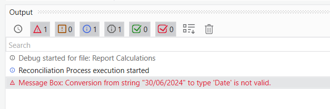

Hello guys i want to get “MMMM” format from the date entered in the input dialog box
Iam entering the date in input dialog activity as (“dd/MM/yyyy”)
So when i use this exp (CDate(MyDate).ToString(“MMMM”))
to get the month iam getting error
So how could i get the month from the entered date
you have to convert string into date format.
please search how to convert string into date
Can you try the following expression instead of CDate?
DateTime.ParseExact(MyDate,"d/M/yyyy",System.Globalization.CultureInfo.InvariantCulture)
Got the solution by using this exp (DateTime.ParseExact(MyDate,“d/M/yyyy”,System.Globalization.CultureInfo.InvariantCulture).ToString(“MMMM”))
