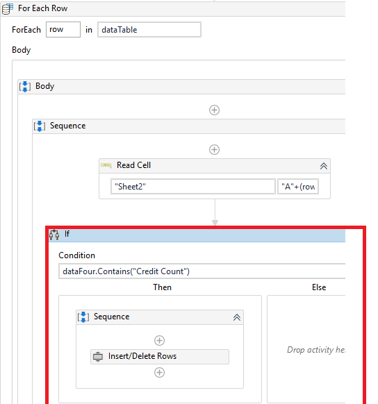

Show error below.
but work complete.
Suggest me please.
dataFour variable not contains any value then u will get this error
Try Debug step by step and check the value for that variable

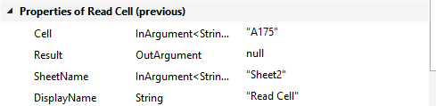

@ImPratham45 I debug , found result = null in R0W A175
Because data in excel end in row A174.
Guide me about it please.
what are you passing in Read Cell?
@ImPratham45 text in column A (string)
I mean what exactly write i can see “A”+(row ?
hI @fairymemay,
This issues normally occurs when a variable has not been initialised (been given a value). I am guessing from the screenshots you’ve attached that variable dataFour
is null. If the variable is a string, try using an Assign right at the beginning of the process that sets the variable to blank, like so: dataFour = ""
This will initialise the variable and should fix your issue.
Also, are you using a row counter for your For Each Row? You should use an integer variable instead of row
. i.e "A" + InputCount
and then add one at the bottom of the For Each Row.
