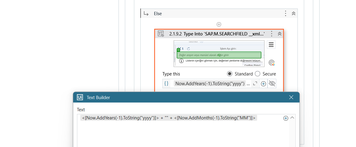

I get the following error in the if activity. How can I solve it?
I want to print 202502 while in period 202503. When in period 202501 it should say 202412.
Thank you for your support and cooperation.
Something went wrong with .
Activity If (If) failed:
Expression Activity type ‘VisualBasicValue`1’ requires compilation in order to run. Please ensure that the workflow has been compiled.
You can find the activity by searching id (press Ctrl + J to jump to activity):
0101F
Hey @ozgur.yukcan
You can simplify the expression without using <[ ]>. Just switch to expression mode in the Text field and use:
Now.AddYears(-1).ToString("yyyy") + Now.AddMonths(-1).ToString("MM")
This works directly in the Type Into activity. The <[ ]> syntax is only needed in pure Text Builder mode, which is not required here.
You can also move the logic into a separate Assign activity using a string variable and use it in type into activity.
If you want to type the previous month’s year and month, it’s unnecessary to use IF activity and the following will work.
Now.AddMonths(-1).ToString("yyyyMM")
