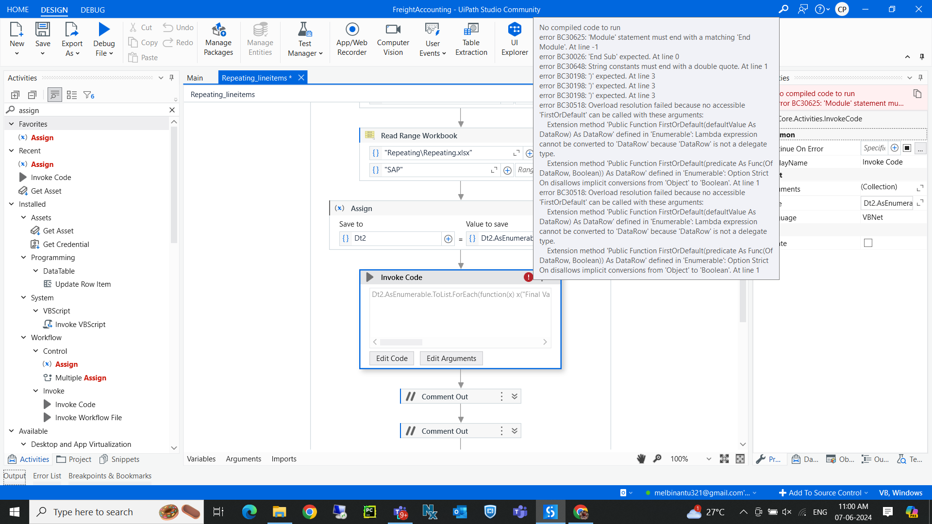

these is the error is facing
@Melbin_Antu
Can you show the error from locals panel please
also in your data every row in dt2 will have a row in dt1?
