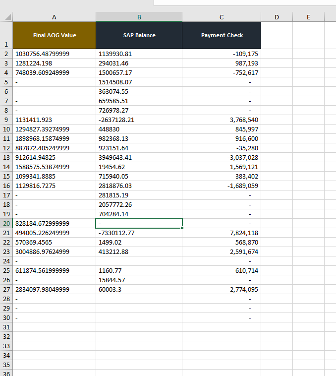

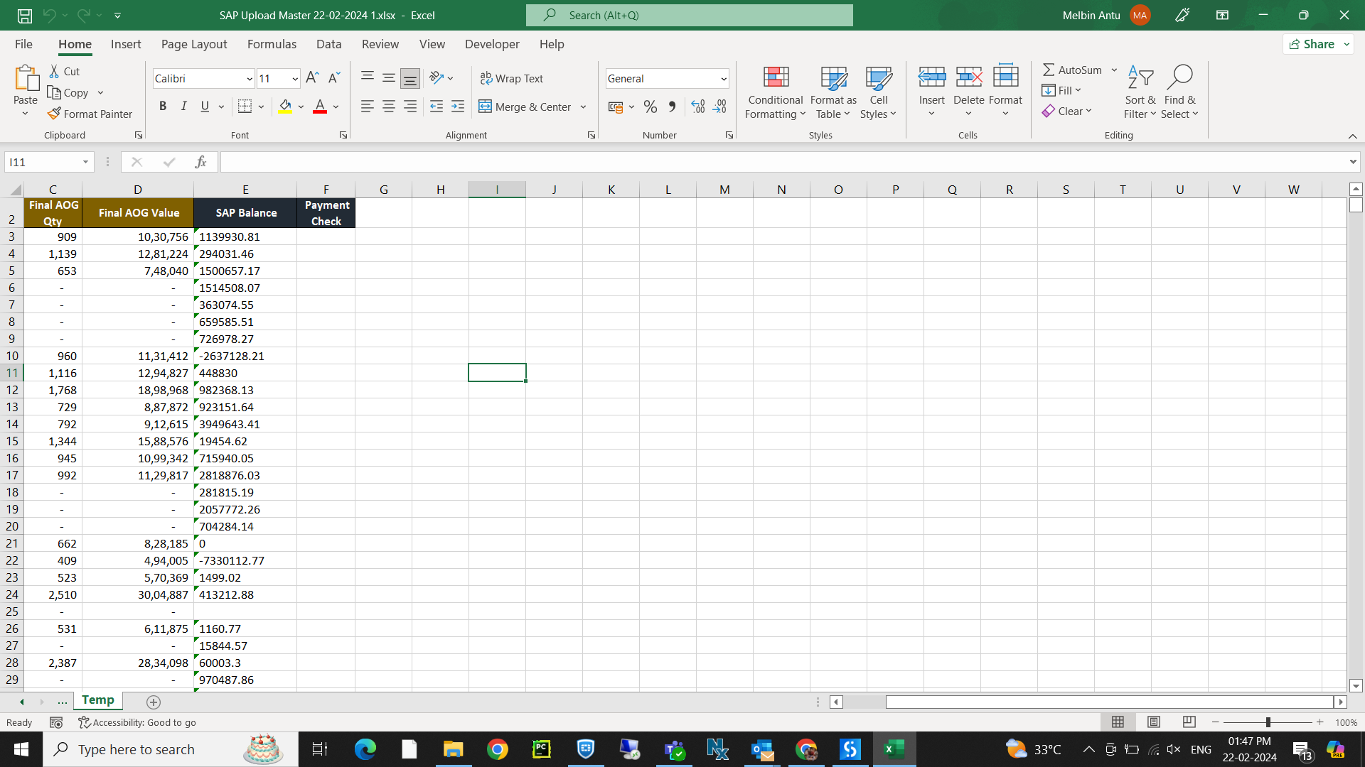

First i want to round off the calue in SAP Balance and after that Final AOG Value substract with SAP Balance and Paste the value to Payment Check
If possible could you share the excel.

you get an idea what i am saying? First i want to round off the Values in SAP Balance and after that Final AOG Value substract with SAP Balance and Paste the value to Payment Check

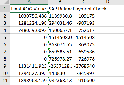

Output:
@rlgandu Before Substraction i want to round off the values in the SAP Balance after that only Substraction where do
Look the SAP Balance Value that is in decimal i want to roundoff the values first

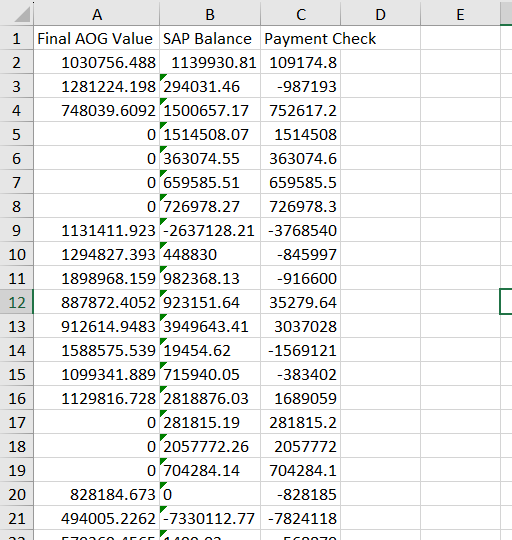

Output:
Hope it helps!!

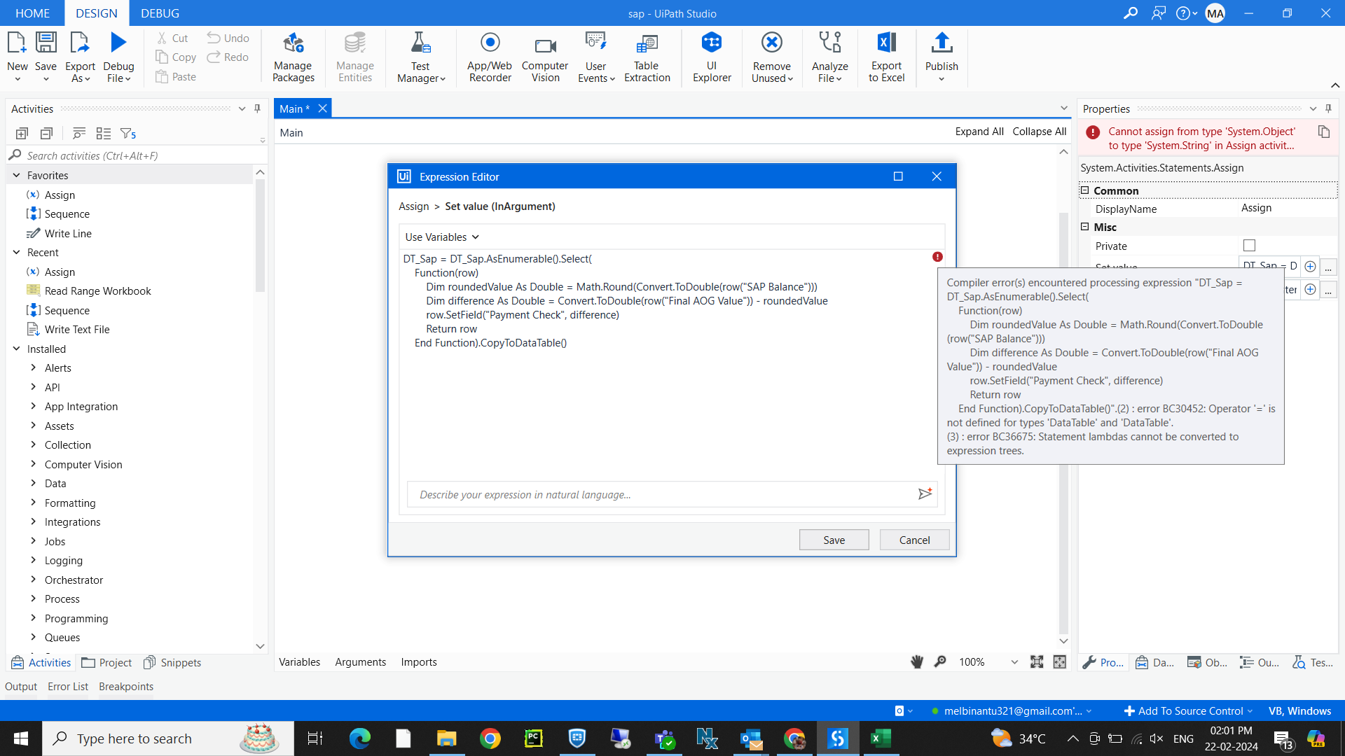

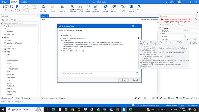

YourDataTable = YourDataTable.AsEnumerable().Select(
Function(row)
Dim roundedColumnA As Double = If(Not IsDBNull(row("Final AOG Value")) AndAlso Double.TryParse(row("Final AOG Value").ToString(), roundedColumnA), Math.Round(roundedColumnA), 0.0)
Dim roundedColumnB As Double = If(Not IsDBNull(row("SAP Balance")) AndAlso Double.TryParse(row("SAP Balance").ToString(), roundedColumnB), Math.Round(roundedColumnB), 0.0)
Dim paymentCheck As Double = roundedColumnB - roundedColumnA
row.SetField("Payment Check", paymentCheck)
Return row
End Function).CopyToDataTable()
