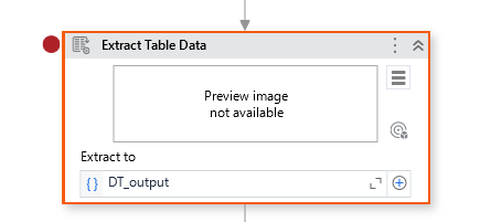

To isolate cause, can you try to set Breakpoint at ExtractTableData, then debug run?
Workflow will stop there, then press F11 and check the datatable has expected data?
If it’s no problem, press F11 some times and check if column is added and input data is stored?
Next Press Continue button, then check the above for the 2nd iteration.
