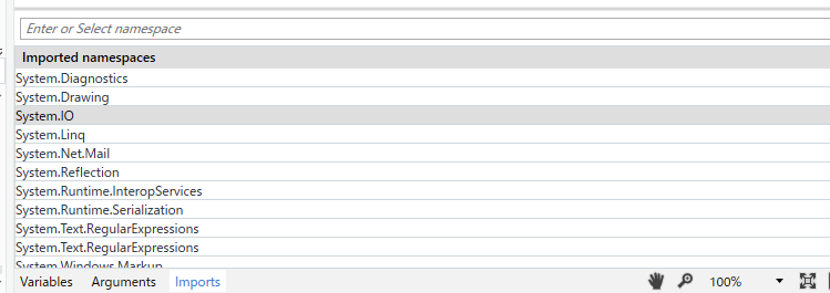

Can you try to define it at Imports tab?
However, sometimes it doesn’t work well. If you face issue, can you try to add namespace to each class etc without using statement.
i have already added both System.IO and itexsharp.text.pdf in the imports pannel but still didnt worked
