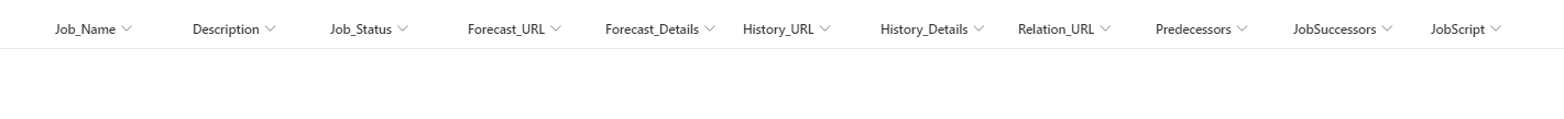

I have a datatable and Sharepoint list with the same headers (Same number of rows and column)
Now I want to update the datatable to the SharePoint list

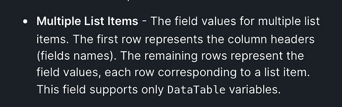

@u322805
Use add list items activity and pass the datatable as input
And the first row in datatable should be the column names in sharepoint you want to add to…and from second row you can have data

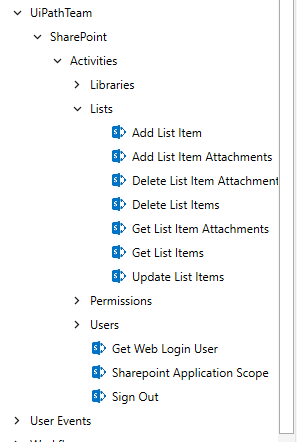

@Anil_G Thanks for your reply
Am getting the add list item like this
No field to pass datatable
@u322805
Can you please confirm if you are using office 365 activities or sharepoint activities
@Anil_G am using SharePoint Activities

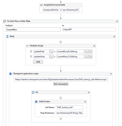

I have tried as you have instructed
Below is the data table
This is the UiPath Workflow I did
The output I received is
Now am getting the first column value as “Key” and the second column value as “Dictionary Value”
But I want the Key as Header and the Value is first row value
Can you guide me on this, thanks
@u322805
Update field would be the column name directly or use dt.Columns(0).ColumnName
And update value would be currentrow(0).ToString
And if you keep add inside loop it would add item for every iteration
Ideally for evry row you have to use another for loop for all column inside so that dictionary will be hving all columns values
In the first loop use this is to initialize dictionary dict = New Dictionary(Of string,Object)
Basically inside the for loop use another for each with dt.Columns and use type argument as columns
And use assign inside it and give
dict(currentitem.ColumnName)=currentrow(currentitem.columnname).ToString

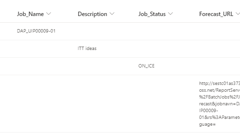

I did as you instructed but columnname is taken as the value and not header
The header should be Job_Name and not DAP_UIP00009-01

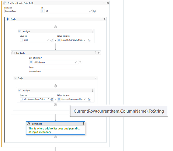

This si what you have to use…you assigned both as values
Keeping : in between wont create a dictionary
Datatable for loop is to be present outside and column loop should be inside

@u322805
This is how it should look
Please correct

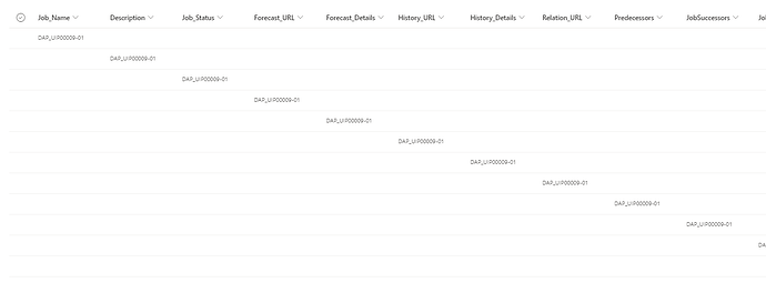

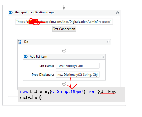

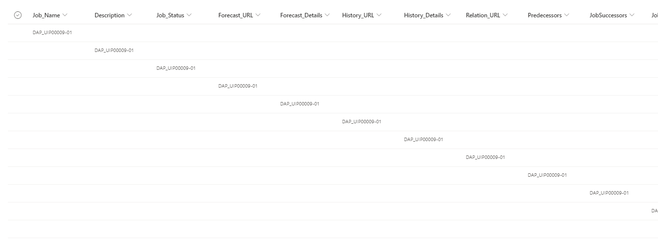

Hi @Anil_G ,
Thank you for this
Used this any idea why the Sharepoint list is updating values in the new row each time instead of updating in the same row
And How to assign the value (in the dictionary) to add to Sharepoint List
@u322805
Can you please show a full screenshot of a your workflow…
Looks like what you did is to use for loop on column and then used currentrow(0).ToString as value…
So the same value is added to dictionary but with different column names as you are looping on column and for each column a new item is added as add item is present inside the loop
What I showed in screenshot is different and what you used is different…currentrow(0) will always take the first column value only

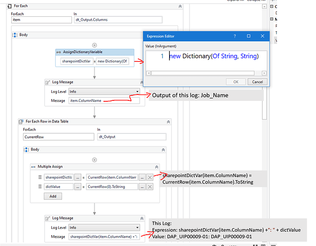

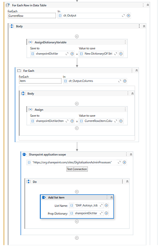

Hi @Anil_G ,
Attaching the XAML file below with this workflow am able to get the details as expected except that list is being added in new rows each time,
I believe Sharepoint sequence should be outside of For each Column loop, so I
tried adding Key and Value to Dictionary inside this loop using “Add to Dictionary” activity and then pass this dictionary variable in Add Item to Sharepoint activity
But the dictionary type is different
Dictionary I initialized is of type Dictionary(of String, Object) but add to Dictionary is expecting Dictonary (of String, String),
how do we deal this

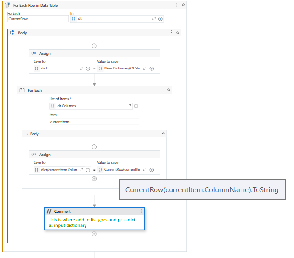

@u322805
This is how it should be …corrected the details
TestingAddListdata (1).xaml (13.5 KB)
