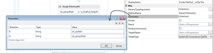

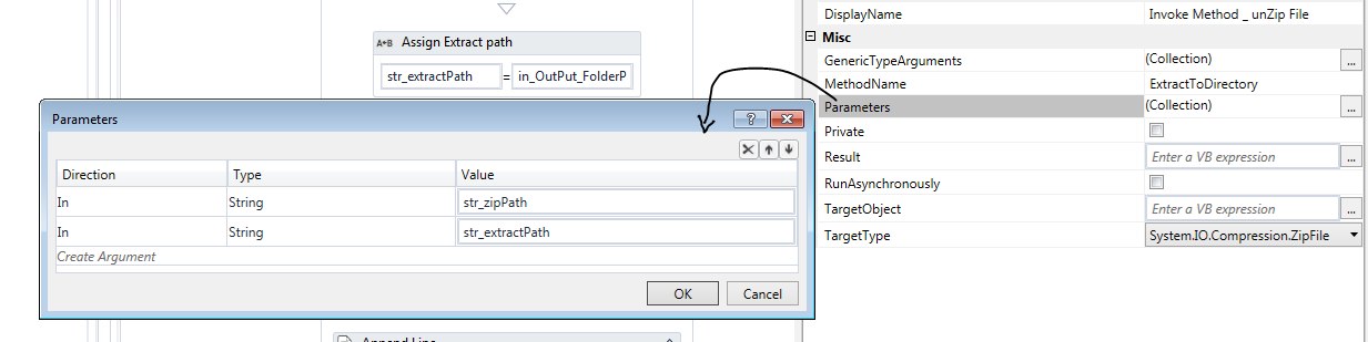

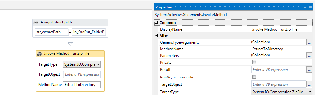

You can use Invoke Code for same.
Mukesh
Hey can you please help me with this,
I am not able to find Target type:System.IO.Compression.ZipFile
mukeshkala
(Mukesh Kala)
8
Go to Import and Import it.
Also , Please update the parameters
