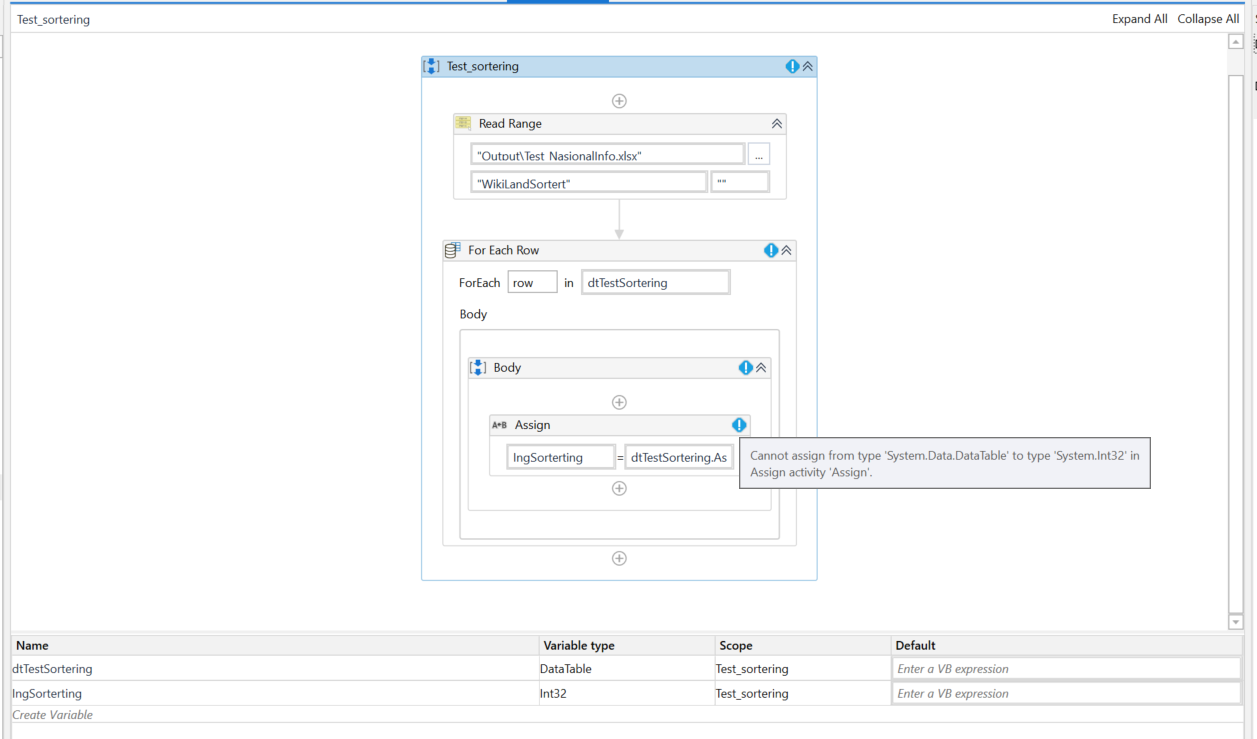

I need some help to sort a datatable where the countries (column: “Land”) are sorted in alphabetical order, in UiPath.
Column A: “Areal” is how big the land - square meter.
Column B: “Land” is the name of the land.
So how can I sort this table, see picture below?
@Mariafig
Give a try on DatatableVar.AsEnumerable.OrderBy(function (row) row(“Land”).toString.trim).CopyToDatatable
Use this Statement in an assign Activity and feel free to assign IT to a new or your Origin datatable

I tried, but I have some problems with the Variable Type. I’m not very good to manipulation variables:crazy_face:
@Mariafig
I will Help you in a few mins, can you Share your xaml with me
@Mariafig
I have sent you an modified file by message. Once I have done with my dinner I will give you a feedback on the edit. However can you check the new file in the meanwhile?
@Mariafig
On the read range the uutput was not configured, so I assigned to a Variable: dtData
You can rename as you want
Following Assign Activity is doing the Sorting of the entire DataTable
Done with statement from above
in the for each row activity I logged out for demo purpose the country
grafik
Kindly note: there is 1 row with blank country name
Let us know your open questions in case there are. Feel free to flag the solution when it is working, so others from the forum can benefit from this.
