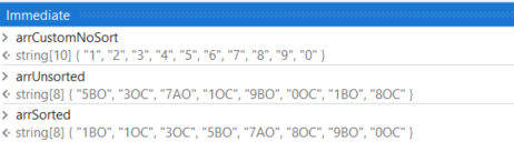

with the restricition, that 0 is after 9 we cannot order numerical
Also we cannot sort lexically
So we would split onf first digit, then second sort on Letter
arrCustomNoSort | StringArray =
Enumerable.Range(1,9).Append(0).Select(Function (x) x.ToString).toArray
arrSorted | String Array =
(From x In arrUnsorted
Let m = System.Text.RegularExpressions.Regex.Match(x, "^(\d)(.*)")
Let d = arrCustomNoSort.ToList.FindIndex(Function (s) m.Groups(1).Value.Equals(s))
Let l = m.Groups(2).Value
Order By d,l
Select v =x).ToArray

give a try at swapping the order prios
Order By l,d
we changed
d,l → l,d
