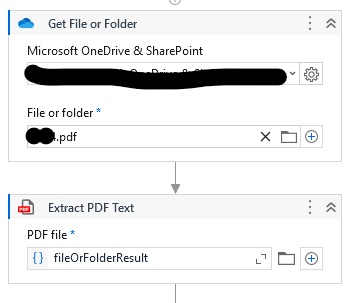

You can use the Get File or Folder Activity under UiPath.MicrosoftOffice365.Activities to get the file from Sharepoint or Onedrive. This requires an Intergration Service Connection to the Sharepoint/Onedrive.
To Extract the Text from the File, you need to use Extract PDF text from UiPath.DocumentUnderstanding.Activities
Here, is a Process flow (Hidden Sensitive Details):

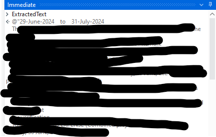

Here, is the Text extracted from the PDF:

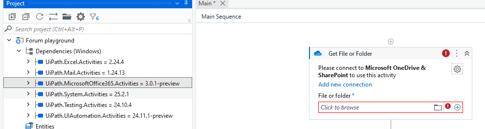

Note: If your development restricts the use of UiPath.MicrosoftOffice365.Activities or UiPath.DocumentUnderstanding.Activities, it maybe difficult.
