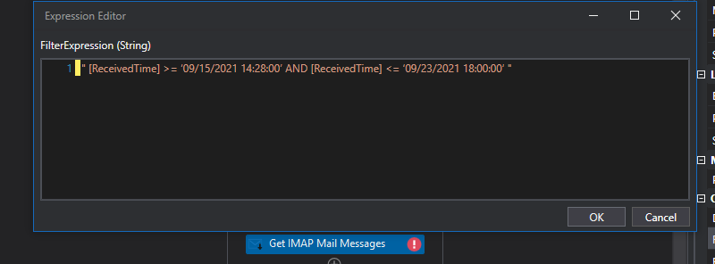

Hi @BNK
You can try to use the expression in the filter properties:
" [ReceivedTime] >= ‘09/15/2021 14:28:00’ AND [ReceivedTime] <= ‘09/23/2021 18:00:00’ "

Hi @Gokul001
That command will work only for Outlook Activities. Here i am using Imap activities

Hi @BNK
Check with the below expression

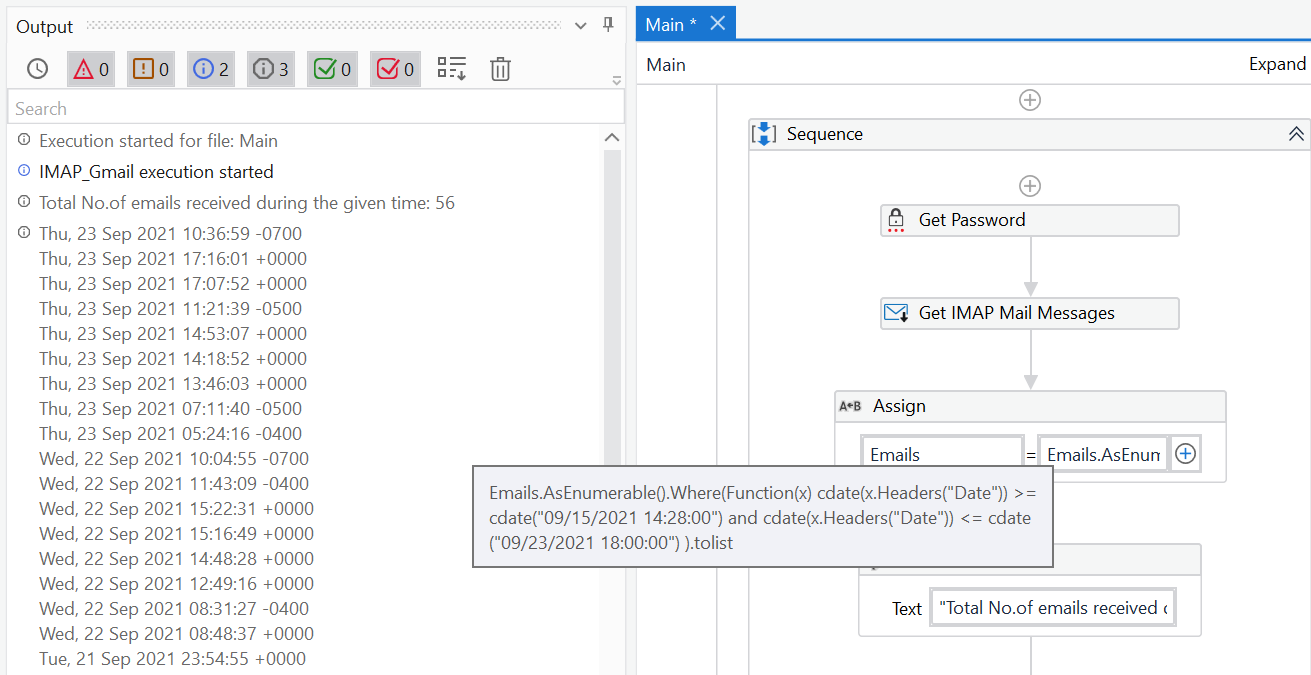

Palaniyappan
(Palaniyappan P )
September 30, 2021, 9:51am
15
Fine
Try with this expression
CDate(item.Headers(“Date”)) >= Datetime.ParseExact((“09/15/2021 14:28:00”).ToString.SubString(0,10),”MM/dd/yyyy”,System.Globalization.CultureInfo.InvariantCulture)
AND
CDate(item.Headers(“Date”)) <= Datetime.ParseExact((“09/23/2021 18:00:00”).ToString.SubString(0,10),”MM/dd/yyyy”,System.Globalization.CultureInfo.InvariantCulture)
