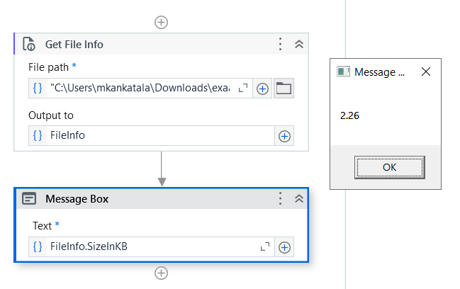

Hi @Smitesh_Aher2
→ Use the Get File info activity to get the information of the file. Give the path of the file in the File Path field and Create a variable in the Output to field, let’s call the variable name as FileInfo.
→ Then use the below Expression to get the file size in KB.
FileInfo.SizeInKB
Hope it helps!!

Hello @Smitesh_Aher2 , Try below expression to get the file memory size in kb
(New System.IO.FileInfo("C:\Users\1122\Downloads\Sample.pdf").Length / 1024).ToString()
New System.IO.FileInfo("C:\Users\1122\Downloads\Sample.pdf").SizeInKB
Try this
(New System.IO.FileInfo("C:\Users\1122\Downloads\Sample.pdf").SizeInKB / 1024)
((New System.IO.FileInfo("C:\Users\1122\Downloads\Sample.pdf").Length / 1024)/1024).ToString()
Okay simply you can divide it by 1000,
Cdbl(FileInfo.SizeInKB/1000)
To get in KB,
FileInfo.SizeInKB
To get in MB,
Hope it helps!!
Thanks @mkankatala & @Gokul_Jayakumar Expressions are working as expected.
