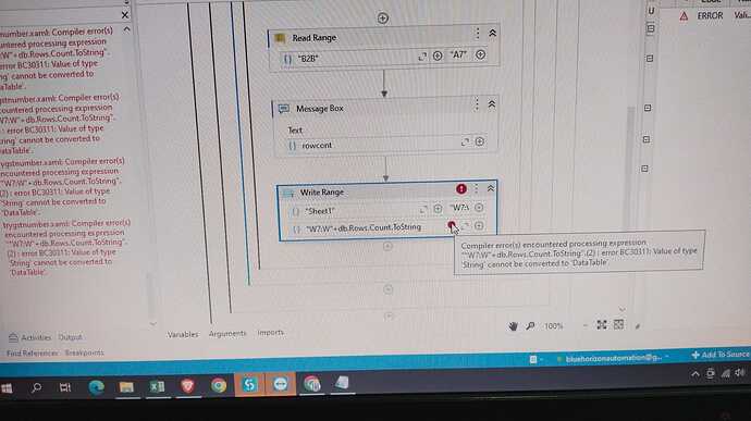

error come as value of type of string can not be converted data table

Use Datatable variables for read range activity.
Share the Error screenshot if possible

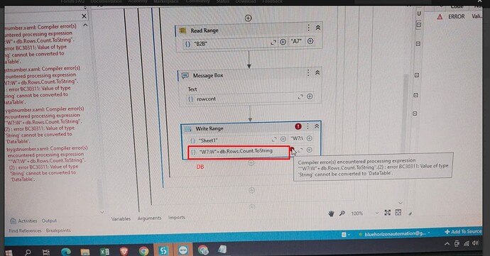

Hii @dhanu_lokhande ,
Actually You were updated the range in the wrong place. You have to put the Datatable name where you put the range. Whatever “W7:W”+db.rows.count.tostring is there that should be updated in right Upper corner.

@dhanu_lokhande
Here you should pass the data table variable from the read range.
