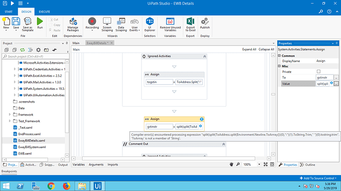

still its not working, i am scrapping address field
buddy take the cursor to that blue mark and share the screenshot of what it shows buddy @smita.mobifly
same error

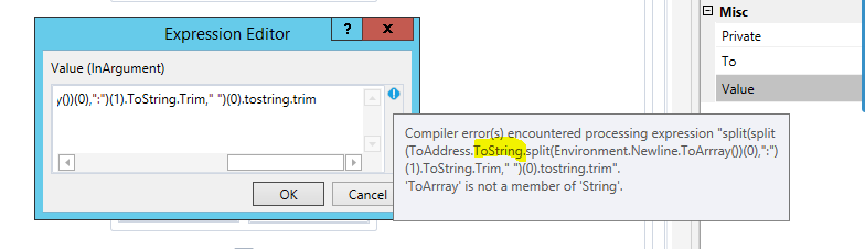

that is what is showing error and i think it must of single line output
Kindly check that and let know buddy with a write line activity
Cheers @smita.mobifly
Hi @Palaniyappan,
actually there is space between the gstin, so that given code is not working, i am getting blank string.
i want only first line after :
Try this buddy
outtext = split(split(intext.split(Environment.Newline.ToArrray())(0)," : β€œ)(1).ToString.Trim,” ")(0).tostring.trim
