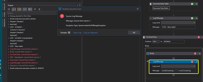

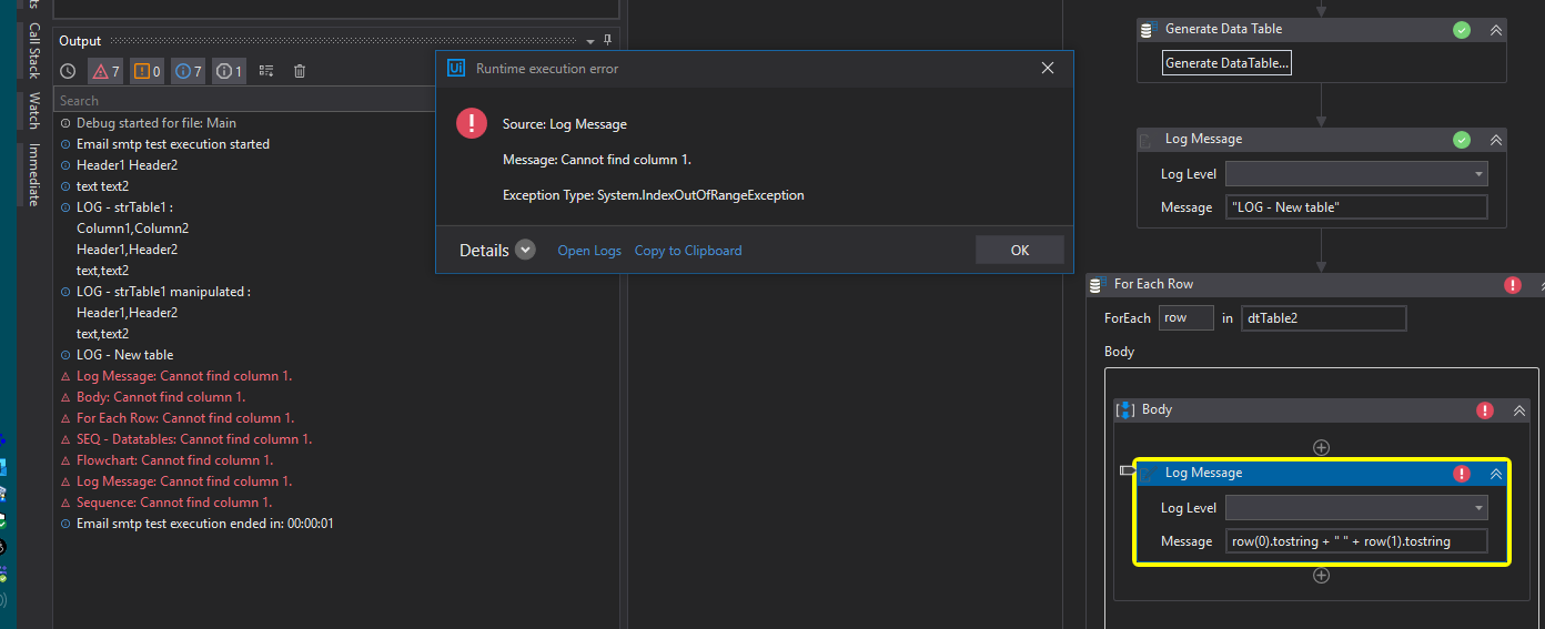

Hey Yoichi,
That’s interesting that you don’t get an error when using UseRowHeader.
This is what I get, If I use UseRowHeader,

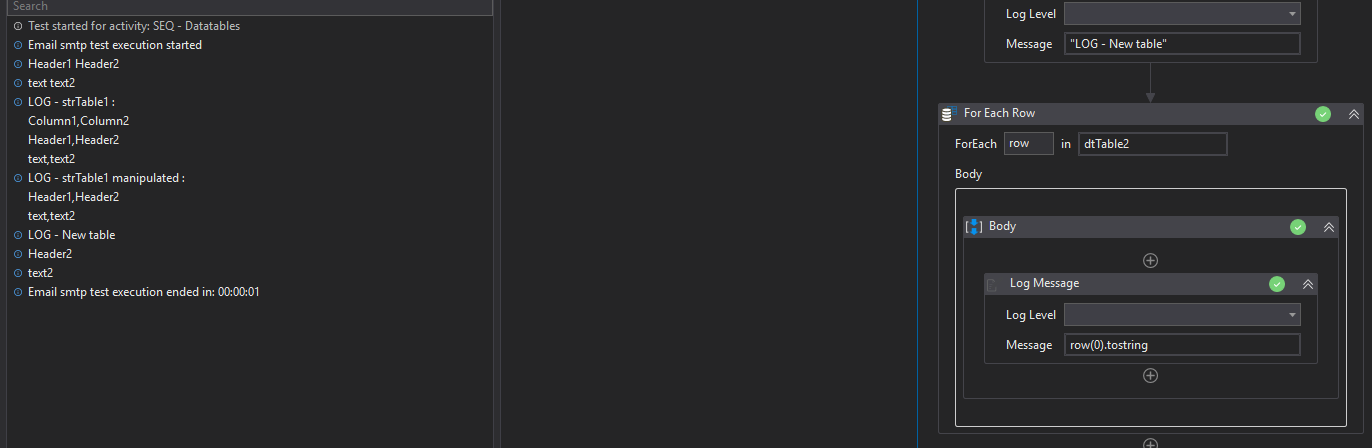

Interestingly it doesn;t error If I just use row(0) then at least something is returned which is the second column? which also seems wrong.
Userowheader is working fine for me
Maybe my machine needs a rebuild :-S
Hi @roy_r ,
If we check UseRowHeader option, the activity considers the first column as a header and delete it.
So if table string has 2 columns, result table has just a column because the above specification.
This is why your error occurred.
That makes sense that it is deleting it - thank you now I understand why it was erroring. Just logically in terms of the English language I would have thought UseRowHeader would mean use the row as the header. Anyway Nikhil is sorted now. and thanks for the explanation that the column was being deleted.
