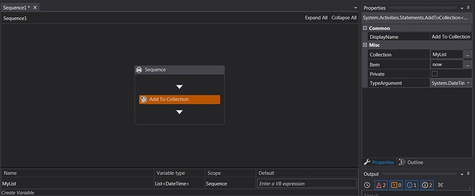

@happygal321 The properties for the ‘Add To Collection’ activity should be as follows:
Collection: This is the list you are using. It should be a list of system.DateTime - it looks like you named it AccPeriod Item: This is the datetime variable you want to add to your list. TypeArgument: Make sure this is System.DateTime
Here is a screenshot showing an example where I have a list of datetime variables called “MyList” and am adding the current datetime to this list.
@Dave I changed my variable AccPeriod to of type List and enter that in the properties panel in Collections. But now i get the error “Complier error(s) encountered processing expression “AccPeriod”. Option Strict On disallow implicit conversions from ‘System.Collections.Generic.List(Of Date)’ to ‘System.Collections.Generic.ICollection(Of System.Collections.Generic.List(Of Date))’.”
@happygal321 please double check that you have updated all the properties as shown in the screenshot and listed in my last response. If everything is the same, please delete the activity and try again as sometimes UiPath has trouble when you change variable types like that
