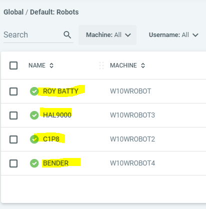

  1. the second issue is that I can’t find anything that allows me to get the Robot Name. I’m able to get the machine name, but I’d love to refer in log to the Ronot name, the one in yellow here:
    Does anyone know how to get this? (if it’s possible)

thank you for n°2!
