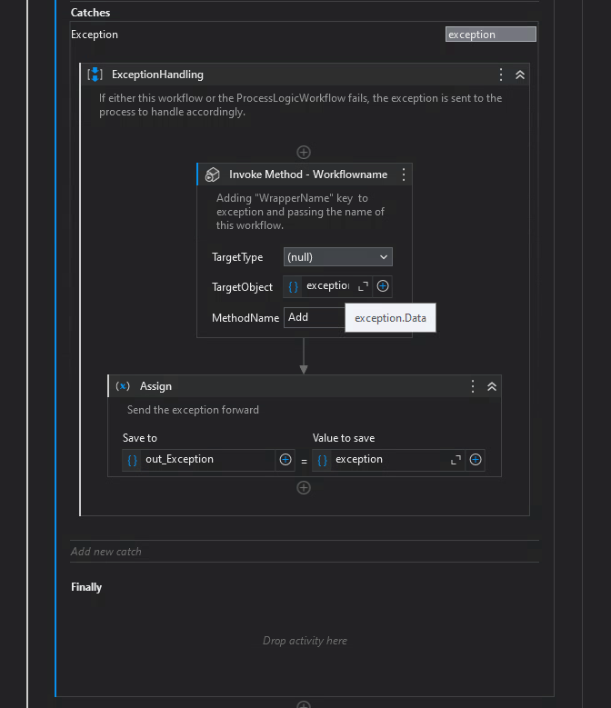

Now you create a new workflow as show in the screeshot of @lrtetala and invoke your ProcessLogic_SomeWorkflowName
. Lets call this workflow as Wrapper_SomeWorkflowName
. This workflows main function is to catch the exception and send it forward to your Process.xaml

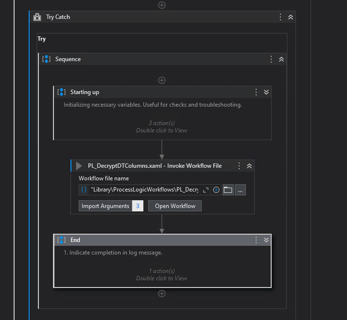

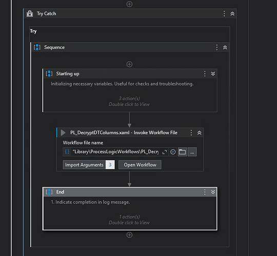

Another important thing is to ensure that the invoked workflow should not be surounded with a dedicated sequence. Below image is the right way to use this approach.
So you see what we did, we now have access to the exception object inProcessLogic_SomeWorkflowName
This will work with many invokes as well in the Wrapper.

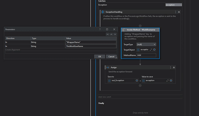

Now in the Catch block you have a lot of options with the exception object. For example, there is a dictionary named “Data” to which you can add additional keys in your catch block. We add an additional key in our Wrappers and call it WrapperName like so.
