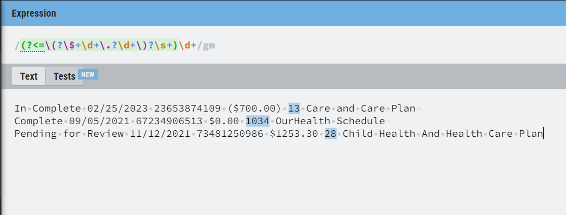

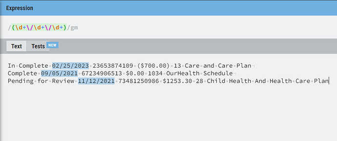

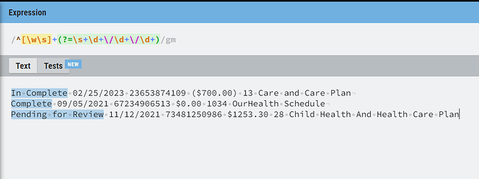

Hi @kavya_mamidishetti
- Variable1 = System.Text.RegularExpressions.Regex.Match(Input,"^[\w\s]+(?=\s+\d+\/\d+\/\d+)").Value
- Variable2 = System.Text.RegularExpressions.Regex.Match(Input,"(\d+\/\d+\/\d+)").Value
- Variable3 = System.Text.RegularExpressions.Regex.Match(Input,"(?<=\d+\/\d+\/\d+\s+)\d+").Value
- Variable4 = System.Text.RegularExpressions.Regex.Match(Input,"(?<=\d+\/\d+\/\d+\s+\d+\s+)\(?\$+\d+\.?\d+\)?").Value
- Variable5 = System.Text.RegularExpressions.Regex.Match(Input,"(?<=\(?\$+\d+\.?\d+\)?\s+)\d+").Value
- Variable6 = System.Text.RegularExpressions.Regex.Match(Input,"(?<=\(?\$+\d+\.?\d+\)?\s+\d+\s+).*").Value
Hope it helps!!

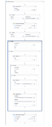

Hello @kavya_mamidishetti
Check the below workflow for better understanding,
2024.xaml (21.4 KB)

Can you try the following sample using Regex.Group?
This sample output not only each value but also excel table.
mc = System.Text.RegularExpressions.Regex.Matches(strData,"(?<=^|\n)(?<STATUS>.*?)\s+(?<DATE>\d+/\d+/\d+)\s+(?<ID>\d+)\s+(?<AMOUNT>\S+)\s+(?<NUMBER>\d+)\s+(?<NOTE>.*)")
Then we can access each value like m.Groups("DATE").Value
Sample
Sample20240128-1.zip (7.9 KB)

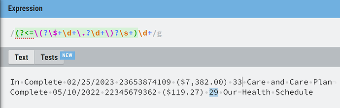

@mkankatala It is able to extract the amount now but variable6 syntax is not working in some cases to extract the number. Please find below screenshot for your reference. Unable to extract number 33 with the current syntax.
Thank you,
@Yoichi Thank you for your work. Will check and get back to you.
Sorry there is change in the Price right ($7,382.00) according to this I have made changes to that regular expressions, check below one now these work for Variable5 and Variable6.
- Variable5 = System.Text.RegularExpressions.Regex.Match(Input,"(?<=\(?\$+\d+\.*\,*\d*\.*\d+\)?\s+)\d+").Value
- Variable6 = System.Text.RegularExpressions.Regex.Match(Input,"(?<=\(?\$+\d+\.*\,*\d*\.*\d+\)?\s+\d+\s+).*").Value
