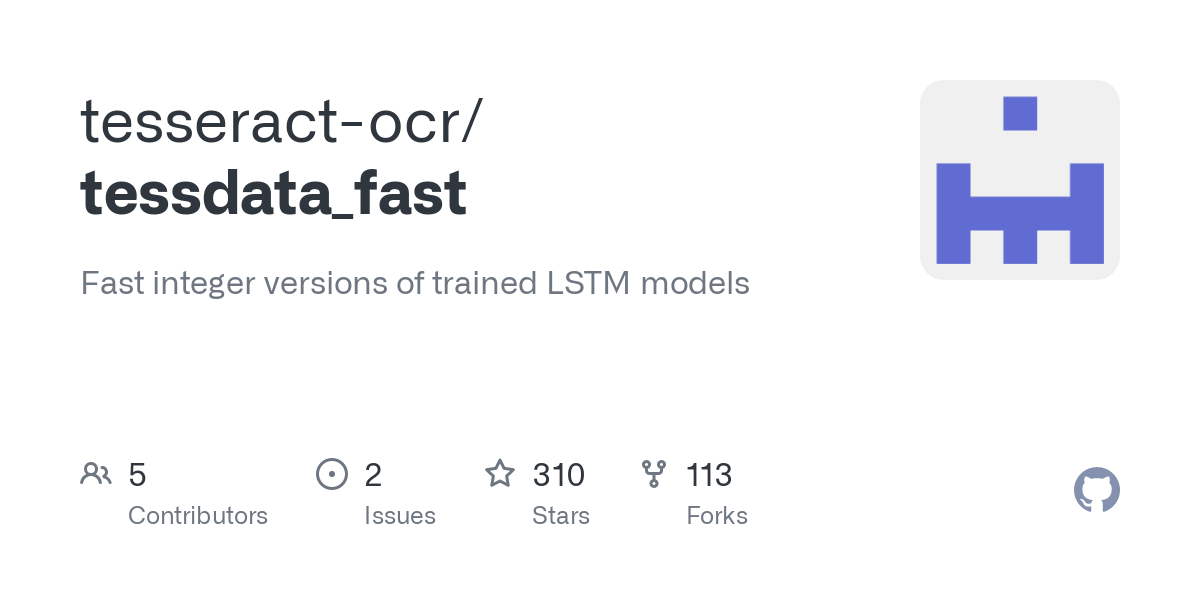

For OCR I suggest Google Tesseract with a languagemodel installed.(slow but free)
I bet some cloud based solution is way faster. Never have tried it that way though.
You can get tons of languages from here:
Language installation instruction:
