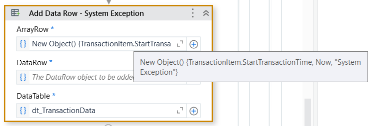

  1. Now Datatable to store transaction details is ready, lets add logic to add transaction details. We will be using 3 Add Data Row activity to add the transaction data.
    A. Success:
    Process Transaction State here
    Add Row
B. Business Exception:
  Add Row
C. System Exception:
  Add Row

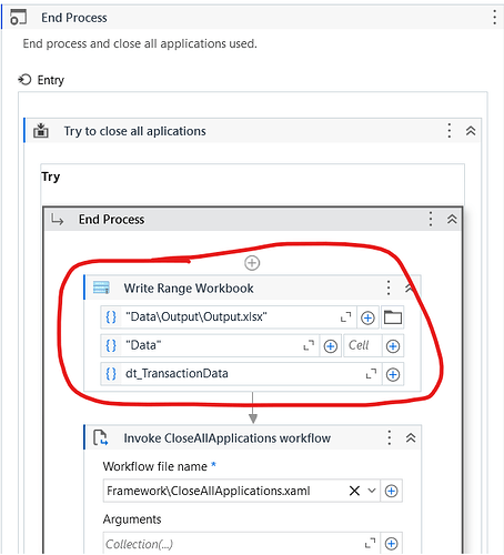

  1. Now for every transaction we will get the data in dt_TransactionData. Now lets write it to Excel file suppose. Use Write Range workbook activity in End Process state.

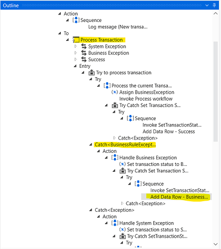

It’s right after Set transaction status Try catch in Process Transaction state.
  1. After invoke Process.xaml
  2. In Business Exception catch
  3. In System Exception catch
Highlighted in my answer.

Hi @naveen.s ,
There could be one way like the below I am sharing the screenshot.
Within the “create summary report” sequence of SetTransactionStatus.xaml file you can have your require action to update the output report file.
If you are using QueueItem start time you can get it by below expression :
in_TransactionItem.StartTransactionTime.Value.ToString("yourDateExpression")
and end Time will be your current time like below:
Now.ToString("yourDateExpression")
Set your value of transactionStatus variable as Success/SE/BE - in the predefined Success/Business exception/System exception sequence.
