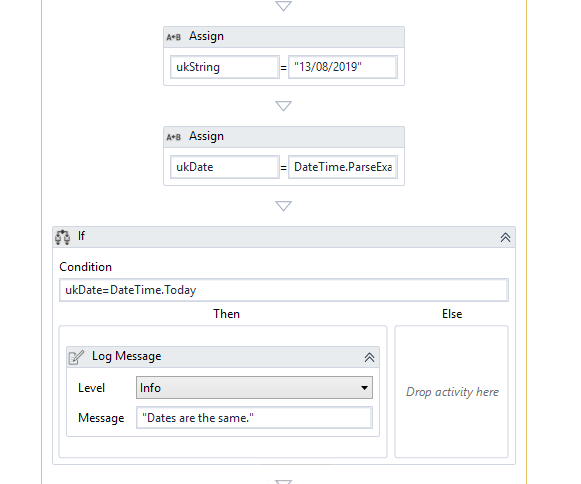

Please see below. I save a UK format date and then store it in a DateTime variable. The right-hand side of the ukDate assign statement below is DateTime.ParseExact(ukString,"dd/MM/yyyy",CultureInfo.InvariantCulture). Then I compare it to today. In this case the code outputs “Dates are the same.” since the If statement is true.
Wow you are correct. It worked with just using DateTime.today. But what if the system date was US and the Uk date was being used. How does it convert accordling.
