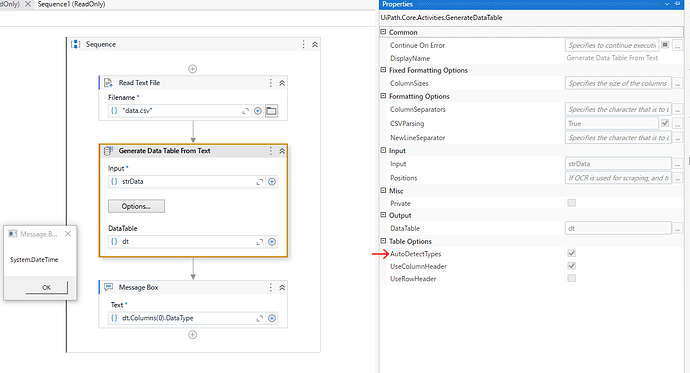

HI,
Although it depends on content of each column, AutoDetectTypes property of GenerateDataTable might work. Can you try as the following?

A .csv file is a text file (mime type). Contents/values in it have no type.
If you read a .csv into either excel or a datatable object the type is determined runtime based on various default settings.
So to change the data types, read the csv first, then convert your datatable afterwards. (Some of the methods mentioned above might help depending on your case.)
But it is important to understand what you are changing where and when.
