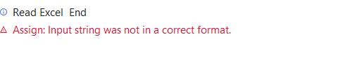

HI, Team I have a column in the CSV file “CreatedDate” this have a Date value but in number format,
My below piece of code is not working, Could you please guide me what is the issue or any another way to convert this

Hi @Techie_Talk_s ,
The Expression used should work, But Could you Check if the Long.Parse() works at first by performing a Debug ?
It does seem that the comma does get affected. However, Maybe try using Replace function to replace commas with empty string at first and we could understand if that is the real reason for the error. There might be empty values as well in the column which might give the error.
So, you could try using the below modified Expression :
DateTimeOffset.FromUnixTimeMilliseconds(long.Parse(CurrentRow.Item("CreatedDate").ToString.Replace(",",""))).Date.ToString("MM/dd/yyyy")
Let us know if you could check the above expression.
Thanks Buddy ,
It works
