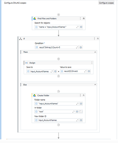

I tried to implement what ever you suggested but get following API error. I checked the folder path also in drive. Unable to understand why its giving API error. Also why output(0). why this 0 .are we trying to get the first element of array (drive id )
@dutta.marina
Yes zero is to get first item of the array…like ideally there would be only one file matching…if multiple matches then we need to make it more unique or find other ways to identify…
The exception is file not found…did you provide the correct file ? Looks like its not able to find the file you are checking for
In the find files I see input_Accountnames…is that a variable?
If yes then you added it as a string and not as variable
You need to add variable like this
"Name = '" + input_accountnames + "'"
Assuming it is a string variable
Hi Anil,
“name = ‘Input_AccountNames’” here Input_AccountNames is the folder name which I am trying to search in my drive .Its not a variable.
@dutta.marina
Then can you please point where exactly it failing and as per error as mentioned before it is not able to find the path or file you are trying to give
HiAnil,
It’s failing in find files and folders .
@dutta.marina
Please check the folder name properly and then use it…
As it is hardcoded value nothing should be missing as well
cheers
Hi Anil,
Even if its not able to find folder it should create one. As we have put if condition. Its not going to if condition also.I have used Service Account key.
