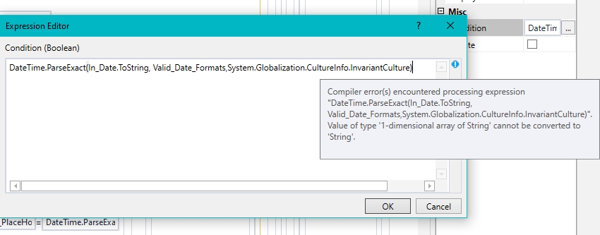

Facing this issue while applying the changes
Yah I was about to tell that
Kindly change the variable name of it instead of From keep the name like in_date.ToString
As it is a keyword we will be getting this error

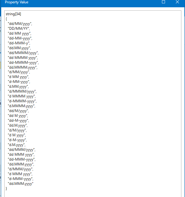

The same issue, is it because of Valid_Date_Format as it is an array?
Oh is it an array
Fine
Then try with this expression
DateTime.ParseExact(in_date.ToString.Substring(0,10), “dd/MM/yyyy”,System.Globalization.CultureInfo.InvariantCulture)

This error occurs, also I need to compare the dates with multiple formats that’s why I am using the array
following are the values in the array
I think you are using this expression in a IF condition or in a WHILE LOOP like somewhere that takes in only Boolean variable in it
Is it so
If so we need to compare that with a DateTime value like
Your current expression > DateTime.Now
Kindly add any such condition with conditional operators we need
Cheers @manzar_ali
Thanks, I needed to change the format type and include times its working now
