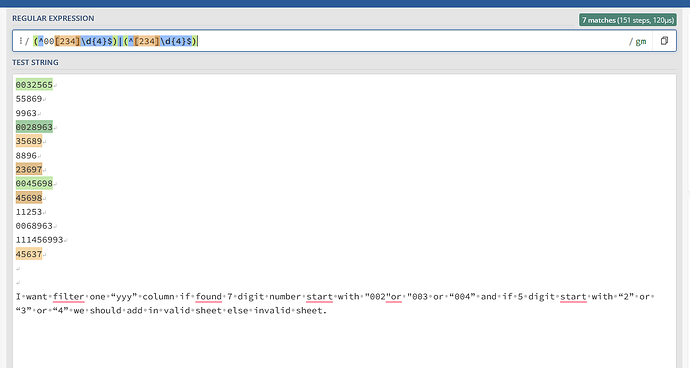

Regex Match for the condition check:
(^00[234]\d{4}$)|(^[234]\d{4}$)

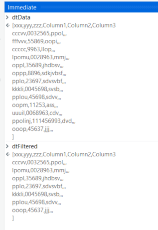

Variables:
grafik
dtData is the result of reading in the excel (e.g. read range)
dtFiltered =
(From d In dtData.AsEnumerable
Let v = d(1).toString.trim
Let chk = Regex.IsMatch(v,"(^00[234]\d{4}$)|(^[234]\d{4}$)")
Where chk
Select r = d).CopyToDataTable
feel free to use the columnname d(“YourColName”) instead of the index d(1)
