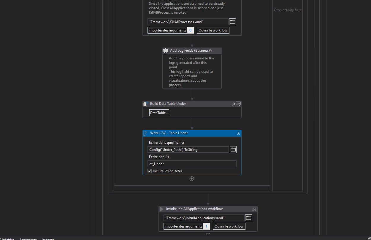

Try this. I’ve added a section to the Init state where a blank table is written to the CSV. The rest of your code is the same. This way, you’ll be appending the data for each transaction after the header has already been added at the initialization step. I put this under the “First Run” section of the Init state so it wouldn’t rewrite the header on a retry.
AmazonSite_Performer_Under.zip (998,3 Ko)
Thank you i will try that now
