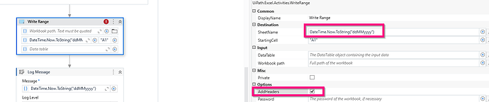

yes, you can use write range activity and specify the name of the new sheet.
or you can consider creating your sheet as date for e.g. 28042025 for today’s date. that way everytime, new sheet will be created for new day.
You can use below expression in sheet name property:
DateTime.Now.ToString(“ddMMyyyy”)
Hope this helps.

@chris.bartkewicz
You can use write range by default if the sheet or file does not exist it would create..if already present then it would write in that

Hey @chris.bartkewicz when you are write your data everyday when the bot run you can use datetime method so evertime bot run it will create a new sheet everyday which better for you as well to check the sheet data as well. as also enable the Header option so bot is write from 2.
cheers
