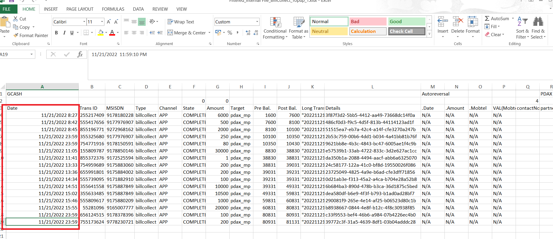

I wanna compare time on this date column to 23:59:01 if time on excel is larger true else false
This is my current code:
datetime.ParseExact(CurrentRow(“Date”).ToString, “hh:mm:ss”, system.Globalization.CultureInfo.InvariantCulture) > DateTime.ParseExact(“23:59:09”, “hh:mm”, system.Globalization.CultureInfo.InvariantCulture)

Hi @joscares
ParseExact should match the correct format, please try the below code for comparing the values
DateTime.ParseExact(“11/21/2022 11:59:10 PM”, “MM/dd/yyyy hh:mm:ss tt”, System.Globalization.CultureInfo.InvariantCulture)
Format description:
2-digit month
2-digit day-of-month
4-digit year
2-digit hour (12 hour format)
2-digit minutes
2-digit seconds
am/pm designator
Will give output : 11/21/2022 23:59:10
DateTime.ParseExact(“23:59:09”, “HH:mm:ss”, System.Globalization.CultureInfo.InvariantCulture).ToString
Will give output : 02/01/2023 23:59:09
Note: I have used “HH” to represent 24 hour format
Based on the values in your Date column in excel, result for all the records will be false.
because when you don’t specify the date in second half of the code. it will always take current date and the first half is in the past date, so (Past > Current = False)
To compare only time between two dates, use “TimeOfDay ” along with above code.
(DateTime.ParseExact(“11/21/2022 11:59:10 PM”, “MM/dd/yyyy hh:mm:ss tt”, System.Globalization.CultureInfo.InvariantCulture).TimeOfDay > DateTime.ParseExact(“23:59:09”, “HH:mm:ss”, System.Globalization.CultureInfo.InvariantCulture).TimeOfDay ).ToString
(DateTime.ParseExact(CurrentRow(“Date”).ToString, “MM/dd/yyyy hh:mm:ss tt”, System.Globalization.CultureInfo.InvariantCulture).TimeOfDay > DateTime.ParseExact(“23:59:09”, “HH:mm:ss”, System.Globalization.CultureInfo.InvariantCulture).TimeOfDay).ToString
