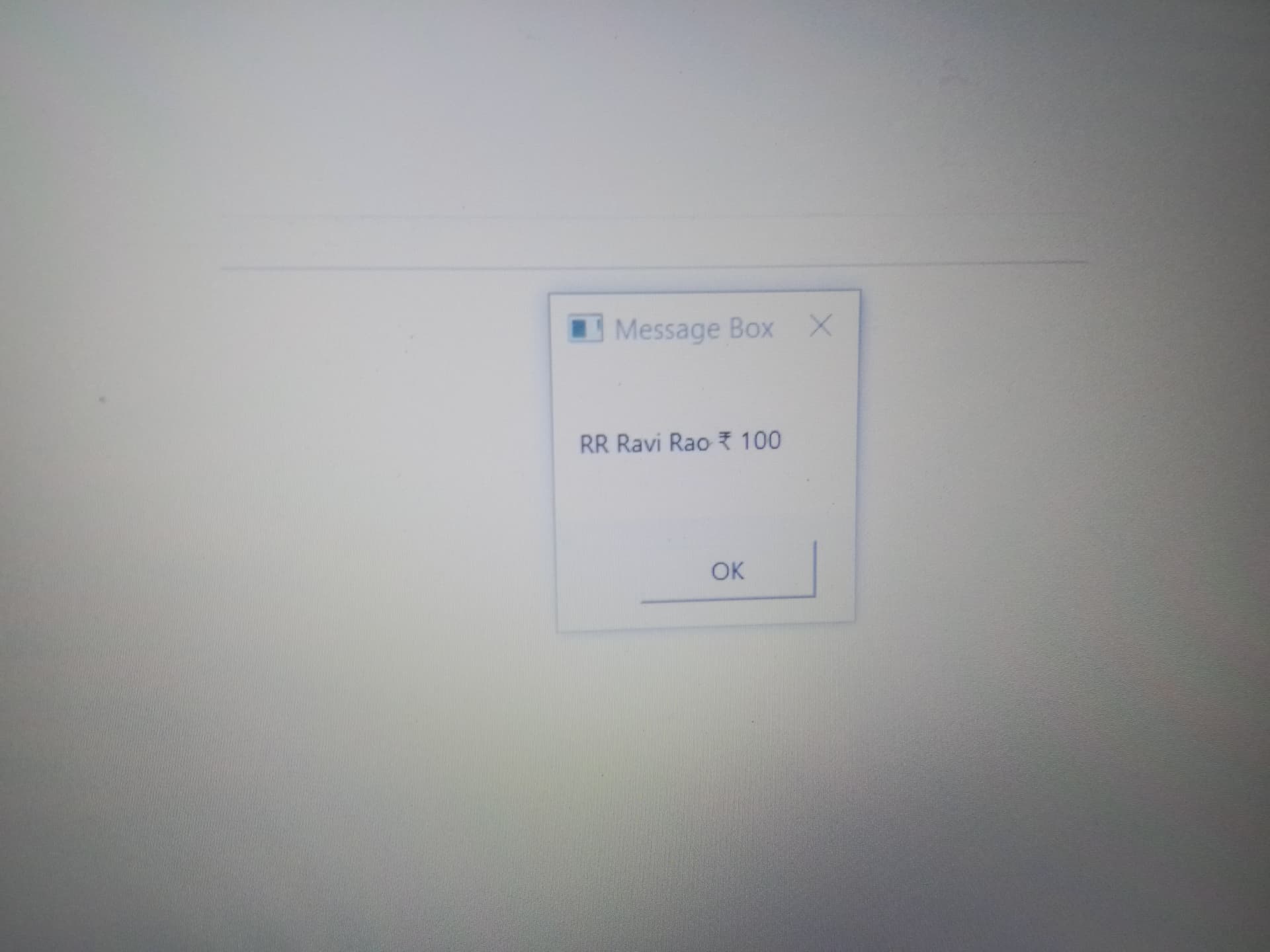

Above picture I want only name “Mantra Mobiles MMRJY” Remove "-"How can i do
We can achieve it using String.Replace method like yourString.Replace("-"," ")
Can you try the following?
System.Text.RegularExpressions.Regex.Match(yourString,".*?(?=\s*\p{Sc})").Value
The following will work.
System.Text.RegularExpressions.Regex.Match(yourString,"(?<=^\S+\s+).*?(?=\s*\p{Sc})").Value
Hey,
It works ,but it’s works only on “Ravi Rao” . I wana works different names like “Surya sai”,“Anil Joy” e.t.c…
Thnq
Regards
K siva
Can you share accurate input string and output?
