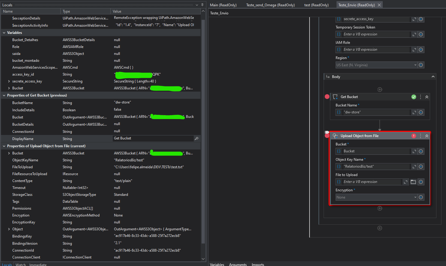

The execution of the process:
Error:
@Felipe_Almeida
  1. When exception occurs expand the exception details from locals panel
  2. As per error are you havign upload permissions? sometimes proxy settings might stop the file from being uploaded as well
cheers
Yes, this user I am using has Upload permission. Regarding the Proxy configuration, I don’t know.
Exception:
This is message:
RemoteException wrapping UiPath.AmazonWebServices.Core.AWSException: Failed to get the bucket details: Access Denied
Error: Access Denied  ---> RemoteException wrapping Amazon.S3.AmazonS3Exception: Access Denied  ---> RemoteException wrapping Amazon.Runtime.Internal.HttpErrorResponseException: Exception of type 'Amazon.Runtime.Internal.HttpErrorResponseException' was thrown.

@Felipe_Almeida
Is the object name correct?
It ahould include any prefix that it has…it would be exactly matching
Sorry friend, I couldn’t understand what you said.
Could you give an example?
@Felipe_Almeida
Can you show the container screenshot of your aws
The objectkeyname you provided can you please check that
you say that?
@Felipe_Almeida
I can see that but can you verify the object key name from aws
