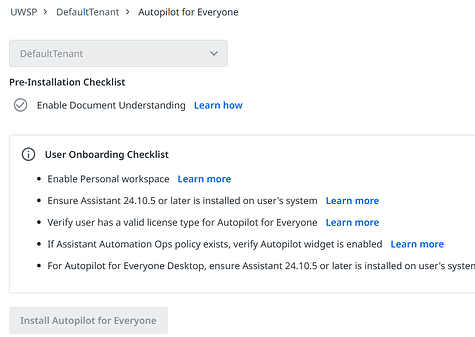

Thank you for your help…that link does not seem to be working for me.
I found this but all of the options were greyed out.
@aduffey
As the steps mentioned
First go to admin → tenant → services and click add services and enable the services you have dpecifically DU
Then if personalworkspace is not enable enable ..mostly this should be already enabled
Remainingn are self explainatory..if you have further questions or issues happy to help
Hello @aduffey
You need to make sure the prerequisites are completed before being able to enable AutoPilot.
If you are in doubt as to how, then click the Learn more links that should show you.
