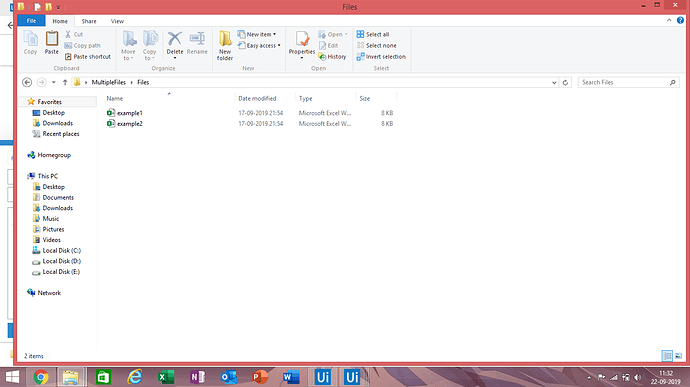

as screen shot above in example 1, i have list of company names and search for their stocks and save in excel
in example 2 i have another set of companies ive to search for their stocks in web and update in excel
