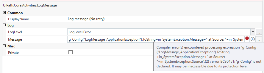

With Studio 2022.10.5, I created a new project based on REFramework. My goal was to remove in_Config dictionary from arguments and instead create a global variable g_Config and refer to that in the project.
So, I started to remove in_Config arguments from xamls and replace the logic to use g_Config. No problems with SetTransactionStatus.xaml, but when I started to fix RetryCurrentTransaction.xaml, suddenly all it’s Log activities give the same error “g_Config is not declared”.
Restarting Studio does not help. However, sometimes when loading the project and/or running Validate Project, I also get other errors also from other xamls, sometimes not. No logic there. One example of one error:

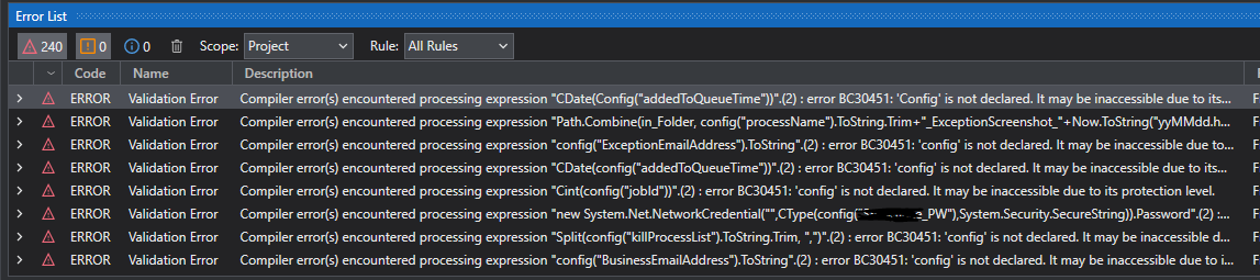

I had this problem once again when I created global variables in an older file. I don’t know what fixed it last time, but I’m pretty sure opening and closing the project eventually fixed it.
That didn’t work this time. I had to Analyze Project, then refresh the Project directory to see all of the xaml files with errors. Then I opened up each one. No errors are ever seen on the activities, but errors show when I run Analyze File. I fixed the issue by creating a variable called “config” (identical to the global variable called ‘config’ that’s having the issue), then Analyze File, which wipes away the errors, then delete the local config variable. I didn’t have to click Analyze File again after this, but whenever I did, no errors were shown.
EDIT:
Nevermind…this let the project run successfully at first, but if the project is closed and reopened, all of the same errors for the same files (plus a few extra this time!) pop right back up @coramia Please help. I may have to abandon updating my older projects, which would be very frustrating.
