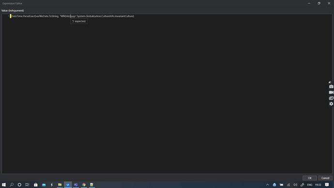

It’s displaying error like ‘)’ Expected
I think since it is showing no validation error
U can run it and check @Aakash_Paliwal
It is displaying error
Can you check none of the variables have GenericType from the variable pane.
varWeDate should be string, varFormateDate should be DateTime.
Now getting new error
“Get Row Item we_date: StringConverter cannot convert from System.DateTime.”
